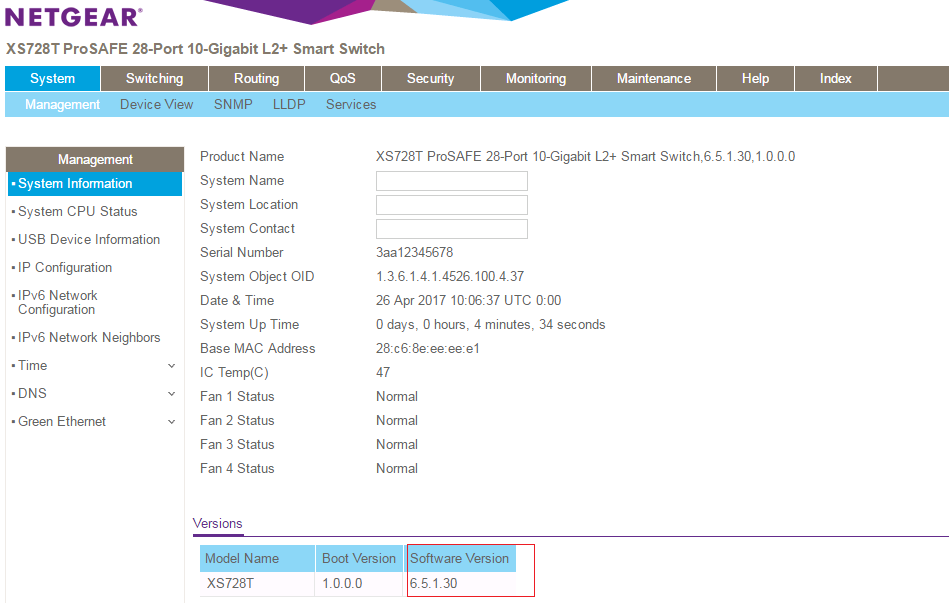

- After the switch is restarted, login the switch to double check whether the FW is upgraded correctly, via GUI page of "GUI page System > Management > System Information".
