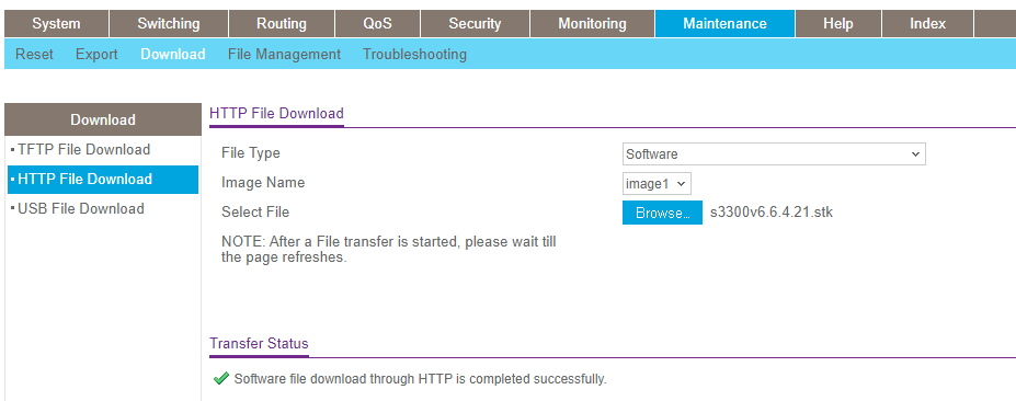

  1. To use HTTP method, in the GUI select Maintenance > Download > HTTP File Download.
  2. Set the File Type as Archive or Software.
  3. Set the Image Name as image1
  4. Select the firmware file s3300v6.6.4.21.stk that’s stored in your local computer via the Browse button, then click the Apply button to start firmware downloading.
    The download takes several minutes. Do not power cycle the switch before. The success message shows up as below
  5. Repeat Steps 2-4.  Set the Image Name to image2 and repeat Steps 3 and 4 to download the switch image s3300v6.6.4.21.stk to image2

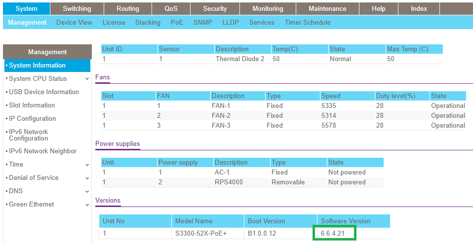

  10. After the switch restarts, double check whether the firmware is updated correctly: a. Log in the switch. b. Select GUI page System > Management > System Information.
    1. Log in the switch.
    2. Select GUI page System > Management > System Information
