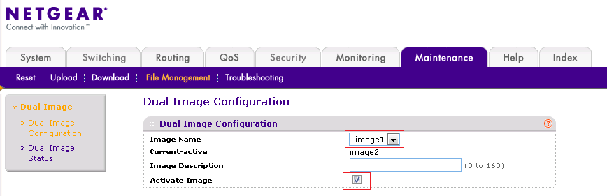

  4. After the successful file downloading, go to GUI page “Maintenance > File Management > Dual Image > Dual Image Configuration’.
    1. If the current-active image is ‘image2’, set Image Name as ‘Image1’; otherwise, set the Image Name as ‘Image2’.
    2. Check and ‘Active Image’ checkbox.
    3. Then click ‘Apply’ button.

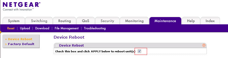

  6. Go to GUI page ‘Maintenance > Reset > Device Reboot’, check the checkbox then click Apply button.
    The restart may take several minutes, do not power cycle or reboot the switch before the process is complete.
